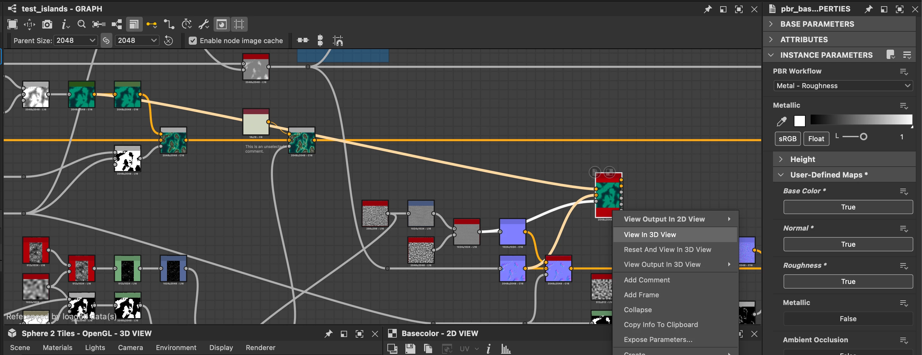

Regarding the graph templates, they are there to provide preconfigured output nodes – and input nodes depending on the template – which ensure the graph is correctly set up to be used in Designer and other applications in the Substance 3D toolset.
As you correctly described, when applying a graph in the 3D View, the graph's Output nodes are connected to the 3D View shader based on matching usages. This makes it so the graph is automatically displayed in the 3D View when loaded (this can be disabled in the Preferences), for instance, or that users can display all its outputs with a single View outputs in 3D View action.
On the other hand, using a Base Material node without Output nodes means several things:
  • No graph output is automatically displayed in the 3D View upon loading the graph
  • Nothing happens when using the View outputs in 3D View option in the graph's contextual menu
  • When the graph is closed or switched to another graph, the manual display of outputs in the 3D View needs to be done again each time the graph is loaded again
  • It is not possible to publish the graph to a Substance 3D asset (SBSAR) as this process involves the portions of the graph connected to Output nodes exclusively
Note: input and/or output nodes can be created automatically out of a node, and will inherit the way the node's own inputs and outputs are configured, including usages.
See attached video template-vs-base-material.mov for a demonstration.
That being said; the Base Material node is very convenient for quick previews:
I hope this addresses your question, let me know if you need further information.
