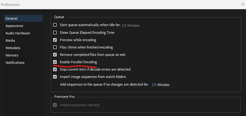

Jan 26, 2023 5:24 PM UTC
you could also try disabling Adobe encoder CC - Edit - Preferences and disabling "enable Parallel enocding"

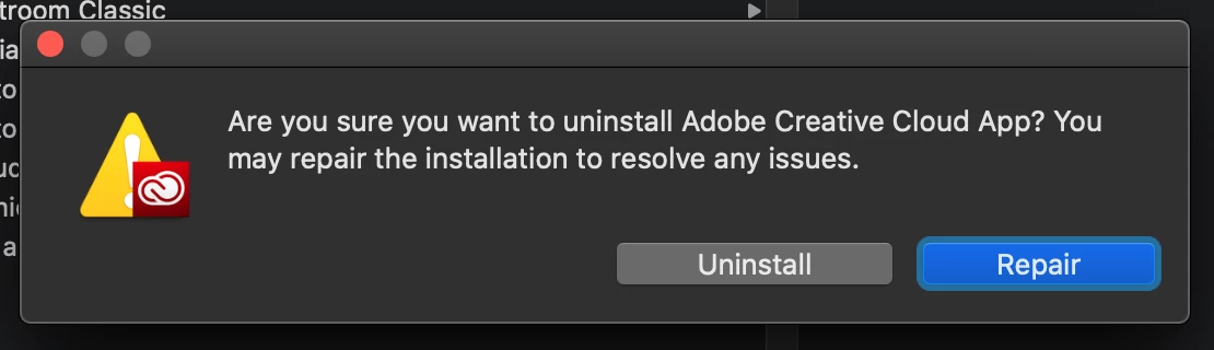

kazzakman
Nov 10, 2020 5:37 PM UTC
The problem didn't stop for me when I uninstalled or updated Adobe Media Encoder, After Effects, or Premiere. It only fixed when I went to the Applications > Adobe Creative Cloud > Uninstalled Adobe Creative Cloud. It gave me this window and I selected "Repair." Since then Adobe Media Encoder has been working for me.
It's so frustrating so I hope this helps you @tasnadiotto

kazzakman
Oct 24, 2020 5:50 AM UTC
I just tried uninstalling and then reinstalling creative cloud. It asked if I wanted to repair instead of uninstalling. I said okay. It's been a week and I haven't had it stop on me mid-export.
I'm thinking it might have something to do with dynamic link 🤷🏼‍♂
