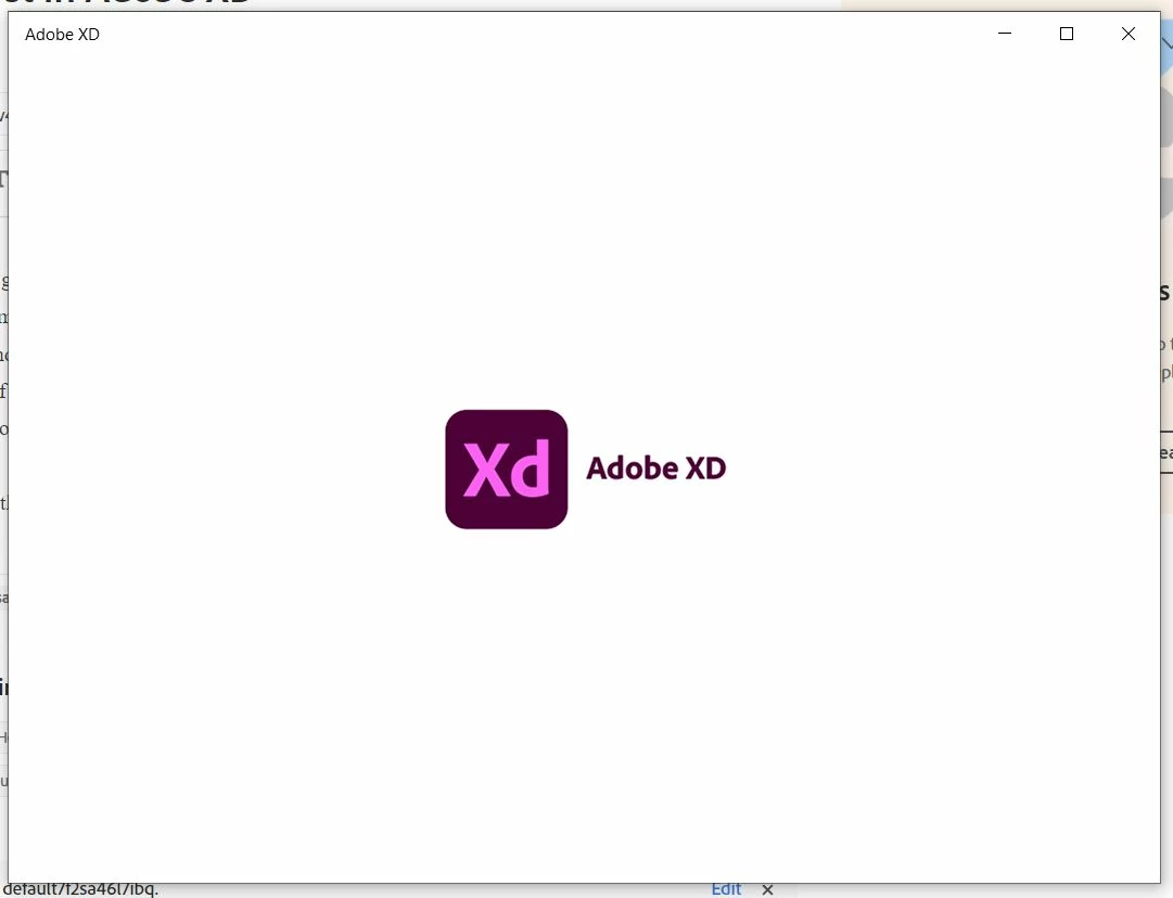

I can't launch Adobe XD. When I open it, it gets stuck on the white loading screen with the XD logo in the middle.
I am using Adobe XD version 47.0.22 on Windows 10.
So far I have tried:
  • Updating my graphics driver.
  • Restarting computer.
  • Unistalling and reinstalling Adobe XD.
  • Signing out of CC and back in again.
  • Opening XD only while CC is no running.
I am really stuck with what to do.. any ideas please?

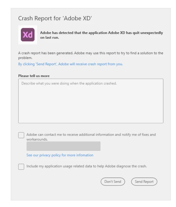

hello, please tell me someone how can i solve this. Adove XD crush. please check this screen short. https://prnt.sc/1l7pbk7
thanks.
