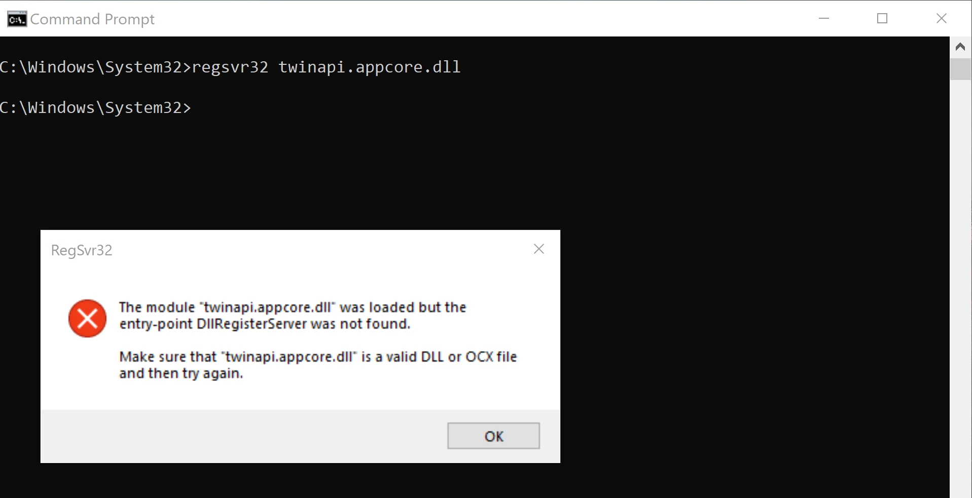

January 2, 2020
I downloaded the XD from the main site, installed, I go in, and then it just crashes, and so every time, what should I do?
nachtmaal
January 27, 2020
This issue is related to https://helpx.adobe.com/xd/kb/adobeXD-launches-into-white-screen-on-windows.html
I tried all the solutions:
Solution 1: Permissions are correctly set on msvcp140.dll and vcruntime140.dll
Solution 2: All graphic drivers are up-to-date
Solution 3: I couldn't find the key so I added it manually.
Solution 4: I could found the error, I did all the steps including uninstalling all Visual C++ Redistributable packages. Afterward, when launching Creative Cloud I got errors and had to reinstall a Visual C++ Redistributable otherwise Creative Cloud wouldn't start.
I also made sure I'm using the latest Windows and Creative Cloud versions.
OS:
Microsoft Windows Pro
Version 1809 (OS Build 17763.973)
Adobe XD: 25.3.12
(I also tried older versions without success.)
AdobeXD.log
2020-01-27 13:28:13.399853+0100[9644] always | Starting Adobe XD version 25.3.12.1
2020-01-27 13:28:13.400723+0100[9644] always | dcx | dcx-cpp version 3.34.2
2020-01-27 13:28:13.401372+0100[9644] always | liveEdit | LiveEditClient version 3.70.07
2020-01-27 13:28:13.570331+0100[9644] always | lifecycle | EEM-Creating-Extended-Execution | [ SessionId, 0 ] | [ Description, Extended execution foreground ] | [ Reason, EEF_Unconstrained ]
2020-01-27 13:28:13.572992+0100[9644] always | lifecycle | EEM-Request-Status | [ SessionId, 0 ] | [ Result, Allowed ]
2020-01-27 13:28:13.573621+0100[9644] always | lifecycle | EEM-Session-Created | [ SessionId, 0 ]
ACPLocalLogs: Not found
Log collector tool: File: AdobeLogs_20200127_123054_116-win.zip
CrashDump: I followed the steps but no dmp file is being generated.
ls_rbls
January 30, 2020
Using CMD > Run as administrator, also did exactly the same with the other two .dll files and in the SysWOW64 folder. Also tried using PowerShell, which gives exactly the same results.
Hi and apologies for taking this long to reply back.
I had to read and read again  through your post to finally understand what is going on.
When you get that message, it is basically informing the user that the .dll's are there but the program that is necessary to load them and interact with the app that is calling for it doesn't exist.
Somehow, those first two DLLs from your redistributables and the twinapi.appcore dll's are now missing or have unregistered the necessary program(s)  to load them up.
So here is what I can suggest
  • Just for troubleshooting purposes, disable your anti virus during the execution of the steps below, and also disable User access Control (UAC)
  • Update Windows and ensure that all of redistributables are downloaded from a current Micrososft link
  • Check for the latest patches  of your OS by verifying what's the latest cahnges in its release notes. If you are missing anything  apply it
  • Ensure that every  licensed program  installed in that computer is also updated to reflect their current version.
  • When done with the steps above reboot your computer in Safe Mode and open  the command prompt as Administrator and run an sfc /scan.
  • take notes of any message that indicate any type of folder or file corruption
  • If there is file corruption detected  use DISM command like so:
    Dism /Online /Cleanup-Image /RestoreHealth
  • Alternatively, if that doesn't work, go ahrad and Uninstall the CC Desktop app if it is installed.
  • Turn off User Access Control (I will explain this later if these suggestions don't work for you)
  • Uninstall XD
  • Download and run  the Adobe Creative Cloud Cleaner Tool. This will remove all traces of of all your CC apps.
  • Reinstall your CC  Desktop app
  • Then reinstall XD
After this is done, go ahead and register twinapi.appcore.dll.
I have more guidancr for you but I will post back after you respond with your feedback
