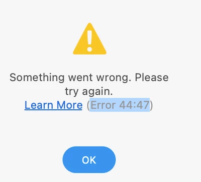

Error 44 when sharing documents in XD.
Some variants of this error message: Error 44:47 and 44:23, 44:63
Try the solutions in the order in which they are listed.
  • Reduce number of assets in your files and retry
  • Split your artboards into two separate files and retry.
While we understand that the last two solutions aren't ideal, the team is aware of the issue, and is working towards fixing it.

Jun 30, 2021 6:50 PM UTC
Been getting these 44:47 errors CONSISTENTLY for at least a month now. Never had it before. The only fix seems to be to just create new local copies of your XD file and try to share the prototype again. Once the file gets a 44:47, it probably will give you the error forever and you'll never be able to generate a link from that file again. Sometimes it takes me 3 or 4 resaves until I can actually get a link. And god forbid you have a small update to make to your online prototype once you've already given a link to your client, there's like a 50% chance trying to update will brick your link and file and you will need to re-save a local file and generate a new link and re-send it to your client.
This is seriously pathetic and a major roadblock in my workflow and collaboration with clients.
Jul 1, 2021 6:00 AM UTC
Like stated in some of the other replies... this is probably caused by symbols. I had similar issues, because I like to design effectively and nest symbols. Some of my symbols were quite complicated and that caused the error. Keeping things more simple, of course thereby less efficient, has cured the problem.
Now, of course, ADOBE... this does not mean that situation is satisfying and the problem resolved!!!
We need to be able to use symbols and nested symbols to their fullest extend, otherwise why bother with XD??
Aug 23, 2021 9:04 PM UTC
I still have the same issue, Error 44:47. Still no solution after almost 3 years!?! Was working fine yesterday, just worked on the file today and got the error message. I researched a bit and tried to find a solution. Restarted wifi, Adobe, Logged out, file without JPG or other "complex" things, just regular text and shapes, nothing else that I did not have yesterday already. Even deleted the pages I added today, nothing works!
Jun 10, 2021 10:34 AM UTC
I was sharing an artboard with about 150 downloadable assets. Got error 44:47 while sharing. I had two assets that were toggle states of the same components. I grabbed em both and ungrouped them so that they are no more states of same component. And boom problem solved. Link updated smoothly.
so check your assets that might be creating conflicts like these.

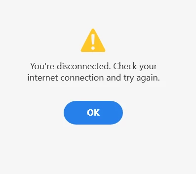

May 5, 2021 1:51 PM UTC
I keep getting this error "You're disconnected. Check your internet connection and try again."
Adobe XD latest version on Windows 10
Wi-Fi connection that seems to be okay otherwise, no issues with other apps or browsers.
Martin Marek
May 5, 2021 5:03 PM UTC
Same for me.
