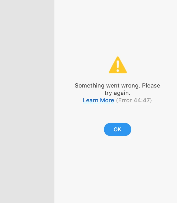

Error 44 when sharing documents in XD.
Some variants of this error message: Error 44:47 and 44:23, 44:63
Try the solutions in the order in which they are listed.

Learn More (Error 44:76)  most times when it gets to 100% created. Checked to see if it could be the size/connection but transfering files via wetransfer is fine..  I also created a small 1 page file (90k) to test the size issue and got this error:
Something went wrong. Please try again.
Learn More (Error 44:47)

When trying to create a link, I keep getting an error message saying "something went wrong. Please try again. Error 44:47". This happens when I try to create a link for a project that was created with a  previous version. It does not happen if I create a new project with the latest version. Thoughts? Solutions?

When i want to share my project it brings Error  44:47
