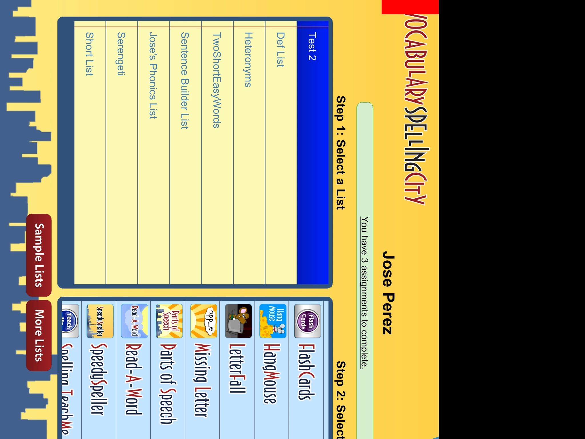

I have a multi-million download iOS app built with Adobe AIR. The whole app x and y axis gets shifted if I launch the app in portrait mode then programmatically change to landscape mode. This happens specifically when I rotate the device to activate the StageOrientationEvent.ORIENTATION_CHANGE event. The red rectangle on the screenshot denotes the new x and y (0,0) coordinates while holding the device in landscape mode. The black area is basically a dead zone. When I click the Home button on the iPad, all the icons are in portrait mode even thou I am holding the device in landscape mode. This is a universal app. The fix that i have in place is breaking the app for iPhone users but fixing it for iPad users.  Adobe, can you help??? Issues happens with AIR 14 and AIR 15.

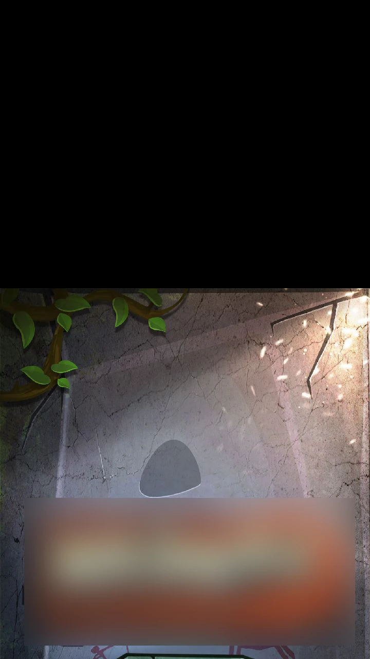

Same here. Our game developed with Starling is broken exactly in the same way. We're using AdColony ANE which shows fullscreen videos in fullscreen mode. When the video window is closed, orientation is messed up.
When should we expect a fix? This issue seriously effects our release date.

pBoom
Mar 25, 2015 12:19 PM UTC
Just downloaded and tried the latest SDK and unfortunately the issue persists. As you can see below. This happens when we show an AdColony video and after the video screen closes.

Jitender thakur, I have sample code that does the same thing and could not replicate. I am using iPad 3 and iPhone 5 in iOS 8. The same app works fine in iOS 7. The issue I have sounds like the consequence for an iOS 8 bug in a native library framework: iOS 8 - OF not setting orientation properly? - openFrameworks especially when they write: "The problem seems to be that iOS 8 no longer changes the screen bounding box after a rotation change. Thus OF tried to correct for the orientation and ends up swapping them unnecessarily (which was required before iOS 8)" ... "  "The app will initialize with OF_ORIENTATION_UNKNOWN and update to the chosen orientation, but the iOS device itself won't reorient." As I said before, when I get a shifted x and y axis and then I press the Home button of the device, the iPad main screen and icons are in portrait even while I am holding it in landscape orientation.
The problem with our code-base I have is that we have a draw() function that gets called on every UI object. These functions get called hundreds of times whenever there is an orientation change. I am trying to track which is activating the issue, so I can share with you. Now, I solved the problem by re-designing both the iPhone and iPad apps to launch and work in landscape mode only with autoOrient false.  This is not ideal,  but hopefully, the app won't get rejected. If I find a simple code example that replicated the issue, I will share immediately.
