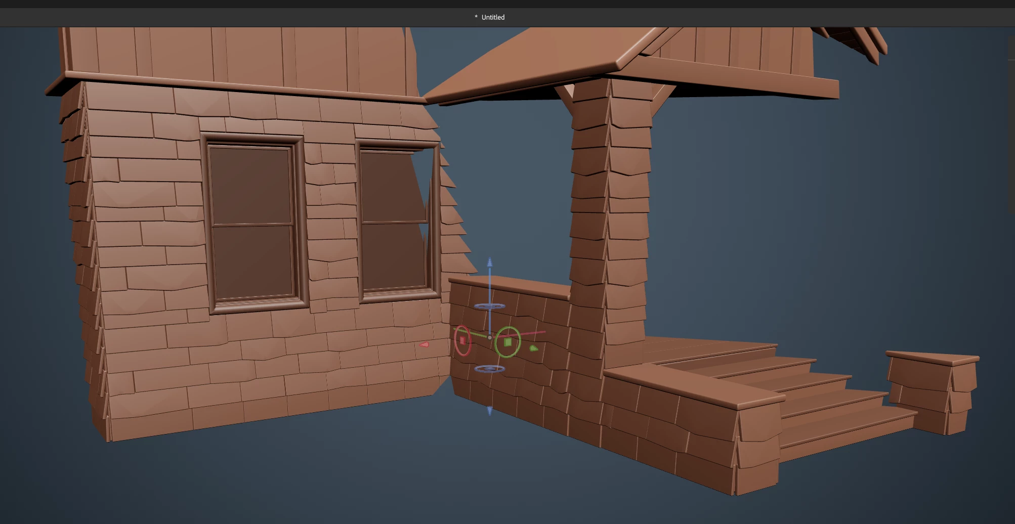

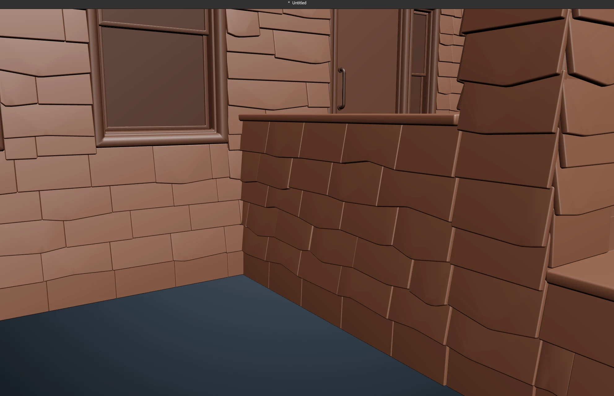

Downloaded a model from 3d assets just to fool around with modeler. After importing the mesh I can only see portions of the house depedent on how close or how far I am zoomed. Seems like the draw distance is very short. How do I adjust this?

I found the solution. When I was importing the mesh, in the pop-up window, I had unit scale set to "Meters (Default)". I switched that to "Auto Detect" and all is good now.
