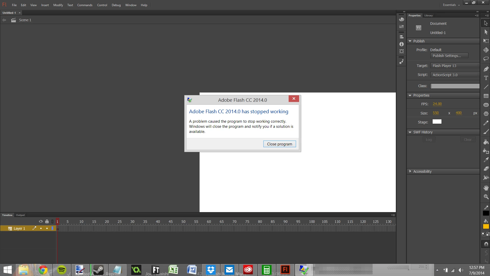

Jul 9, 2014 1:50 PM UTC
Hey, another user here with the same issue. I've had similar issues with some other applications when using a Wacom tablet, for example Autodesk Sketchbook Express.
As Sangeeta has mentioned the problem is with the high DPI settings. I've found that decreasing my resolution to 1024x768 resolves this particular issue, the problem is that the program workspace is rather crowded and difficult to work with. Not an ideal solution.
There is a quick fix I've used to solve problems like this in the past without having to change my 1920x1080 resolution, e.g. aforementioned Sketchbook Express as well as a couple of games including Pixeljunk Eden. Opening up the file location of the program in question and going into Properties > Compatibility allows you to check a "Disable display scaling on high DPI settings" option.
This would all be well and good, except I've found that when you use this fix Flash CC appears to crash the moment you try to put anything on the canvas. Further in this instance it doesn't matter whether or not you use a Wacom device or a normal mouse, the program crashes either way.

Jul 9, 2014 5:12 PM UTC
Here's a screenshot of the crash message, unfortunately there's no error code or anything like that so I'm not sure how helpful this will be.
This occurs the moment I attempt to use the brush tool on the canvas.
Interestingly I played around with the program in the 'non-scaling' setting a little bit more, I found that it's possible to put shapes on the canvas without crashing. However interestingly, in addition to behaving very strangely, placing these shapes results in the same glitch originally described at the beginning of this thread. That is to say, at the moment a shape is placed, the origin point of the shape is displaced from the mouse cursor's actual location, where it should be.
