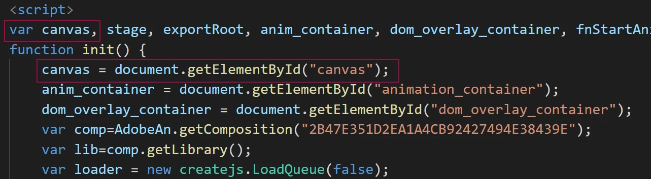

kdmemory​: Actually Animate CC creates a global variable called canvas that holds a reference to the default canvas element with an id of canvas.
