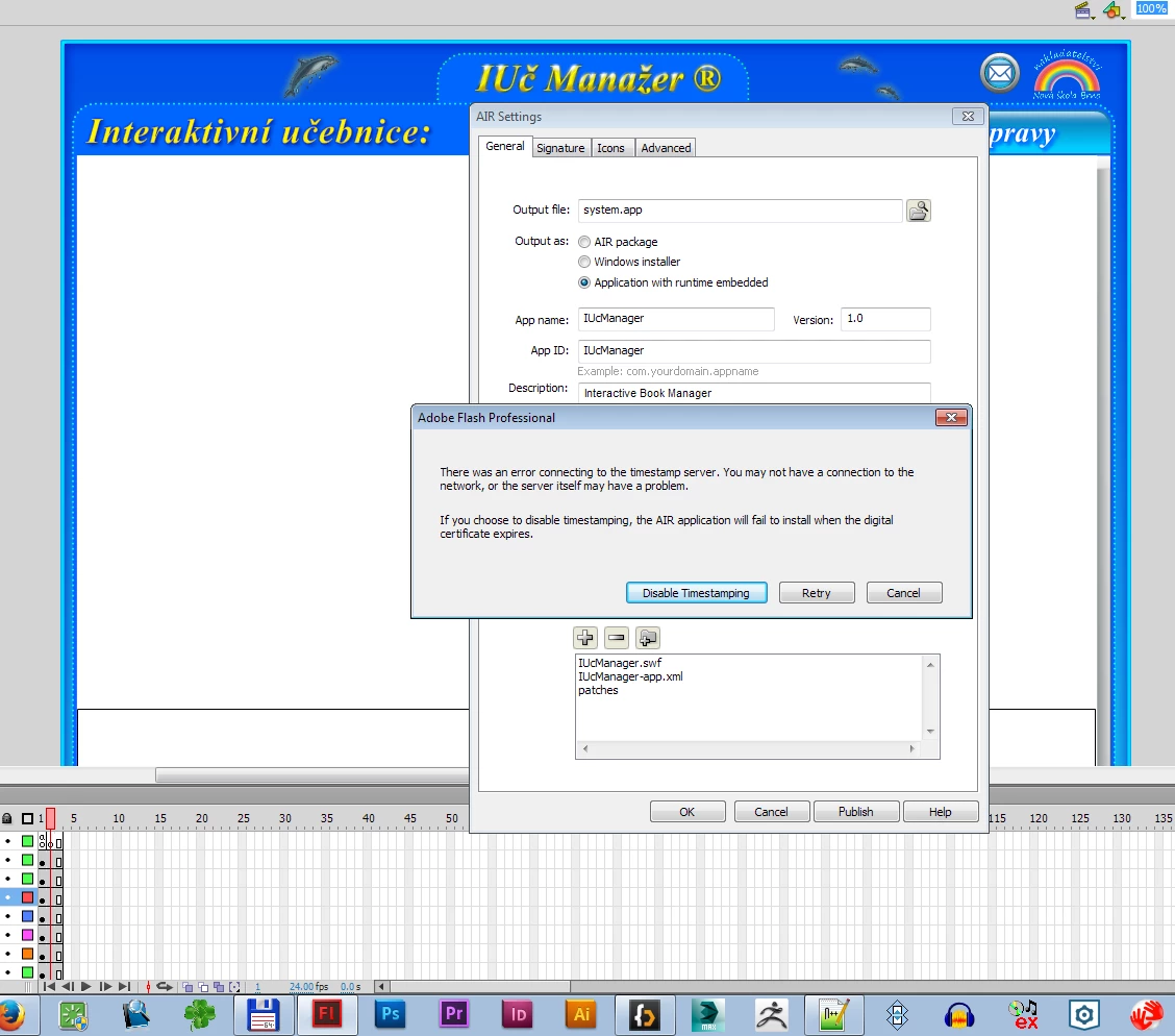

Hello, I use Adobe Flash CS6 Pro to create AIR presentations and when I try to build an AIR application,
Flash fails to create the timestamp for the self-signed certificate and shows an error
"There was an error connecting to the timestamp server. You might not have a connection to the network, or the server itself may have a problem".
When I do little research I was found that server which is responsible for this is offline.
http://downornotworking.com/timestamp.geotrust.com/
Is there any way to redirect Flash CS6 to different server for timestamp?

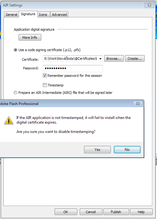

Correct answer Orien
One more test with english Flash Pro CS6 installed.
Here can you read it in you language.
after endless research only way which I found is:
1) publish air file with unchecked Timestamp
2) and after use microsoft SDK signtool.exe
create SignIt.bat with cmd:
signtool.exe sign /f myCertification.pfx /p **pasword** /t http://timestamp.verisign.com/scripts/timstamp.dll myFile.exe
road is not always straight, but you can go around...
