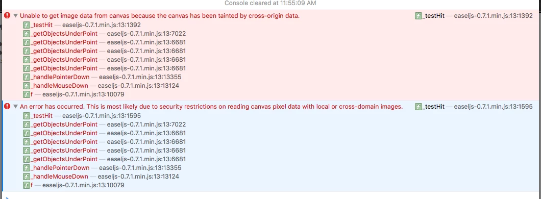

When I open a browser and open the html file it freezes. Then the JS console gives the same error about cross-origins security. But the images are displaying fine. If I remove the ClickToGoToAndStop code it works fine and the images display fine. It is the code that seems to be making an issue.

Then stop worrying about it. Some browsers freak out and trigger false cross-domain security warnings when content is loaded from the local file system instead of a web server. That's why test mode in Animate runs the page through a local web server. Your content will work fine when uploaded to a web host.
What's changed to cause the errors is most likely your web browsers, not Animate.

ClayUUID - attached is a screen shot of the web console. I am not sure what the error means.

Does someone have any insight to what the errors in the screen shot are and how I can correct them?

Well, it clearly says it's having a cross-origin security issue. Are you loading an image into the canvas from somewhere else? Does this happen even when testing the document from within Animate?
