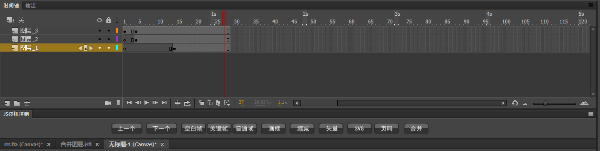

    Now I have a problem where my code can be used, but usually the first use will miss several keyframes.
    After several errors, the layers are merged properly.
    I don't know where the problem is.

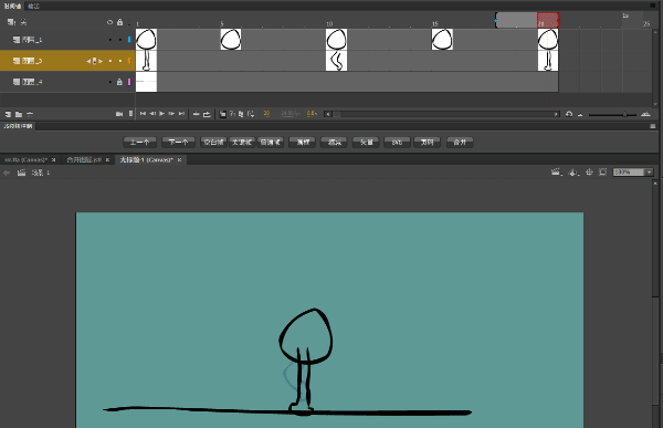

    The sort required
    The merge layer will be in the middle when selecting from the top.
    It's the right choice at the bottom.
    I want the merge layer to be at the top of the selection layer, not the middle

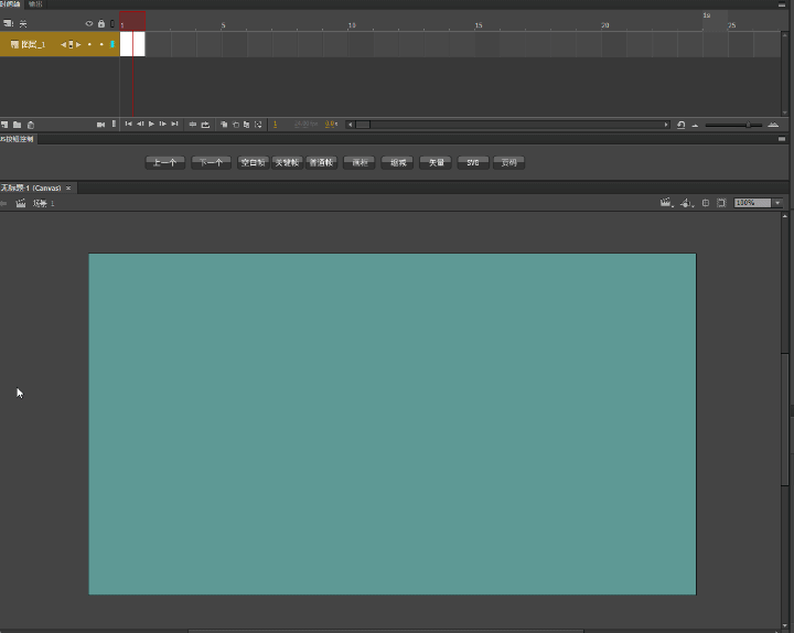

    Manual operation
    If there's no JSFL, that's how I operate.
    Not only operational trouble.
    Errors are also prone to occur.
    If it's a hundreds of-frame animation, it's a lot of work.
