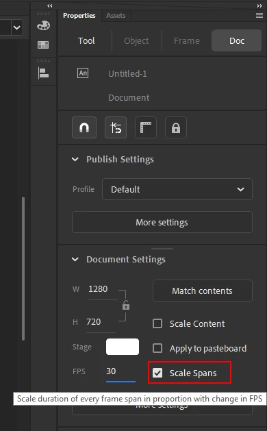

You shouldn't need to select anything in the timeline in order to change the frame rate. Instead you look in Properties, Document Settings (click on an empty part of the stage for that to appear), then check the Scale Spans box, and change the FPS from 15 to 30.
Hopefully you have been trying to change the frame rate without having that box selected.

That would double the playback speed. The timeline needs to be stretched to double the length to match the doubling of the frame rate and keep the animation length at 30 seconds.
Colin Holgate
Mar 21, 2022 7:20 PM UTC
The scale spans option does the doubling of the timeline length for you.

If you want to modify the entirety of the timeline though, why not change it using Scale Spans? It proportionally scales the frames with the FPS, no need to do it manually.
