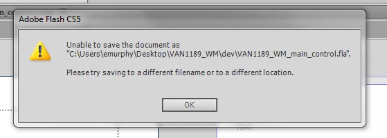

    Same thing here (Windows 7).  Happened twice while upgrading a CS4 project to CS5, embedding fonts.
    This is the error I receive when attempting to save the file
    After clicking OK, I dig around for the problem. I notice the empty (Font 1) style not associated with a Family (this was not created by me)

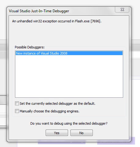

    Eventually Flash crashes while trying to save the file again
    After Window's attempts to debug the issue, this is the window I receive

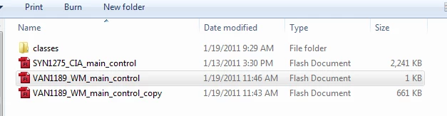

    After selecting "No", and checking my file again, it's set to1 KB now, essentially deleting the contents of the FLA. (The first time I received this error it removed the FLA altogether).
