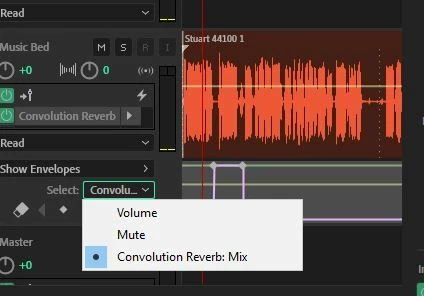

If you have a suitable environment, then running a pass through that and recording the result would be ideal. Other than that, try experimenting with the Convolution reverb using the 'In the other room' impulse, adjjusting the mix to suit.
As for an A/B output, then all you really need to do is have the effect available on the soundtrack, and use the automation system to set the mix level appropriately (you can see the envelope in the background):
Then you can cut to the 'room' version whenever you need to.
