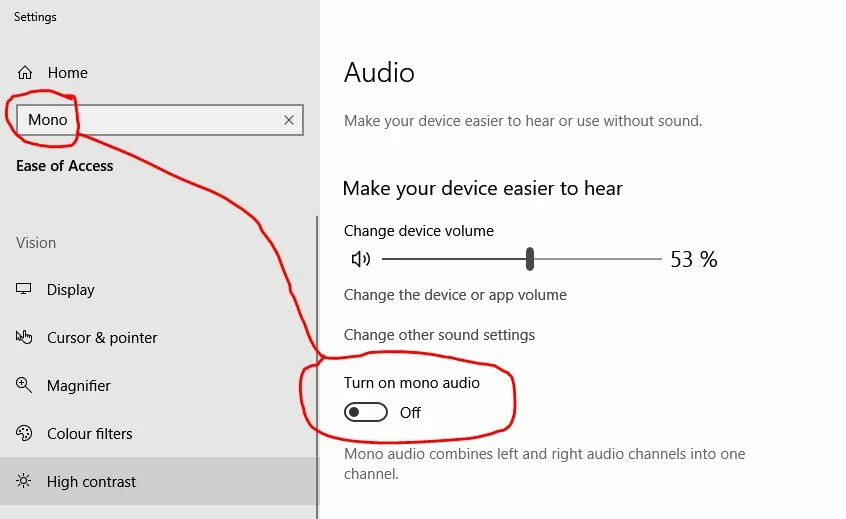

Hmm... three months? If you go to the sound settings in Windows and type 'mono' into the search box, it will take you straight to this:
And if you turn on the mono option, then stereo mix does indeed record in mono on two channels...

That screen don't look like anything I see in Windows 7 64.
