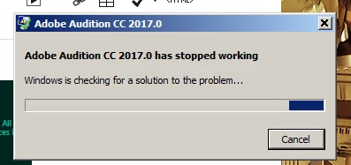

Adobe Audition CC 2017 crashes on startup Win 7 - Core i7 (32GB Ram)
Salutations,
Previously, my Adobe Audition CC 2015 work marvelously.
Once I updated to Audition CC 2017, it crashes on startup and will not function at all.

    I solved the issue.
    It appears Audition CC was chocking on a corrupted graphics driver by Intel.
    The location was --
    C:\Windows\system32\ig9icd64.dll
    The suspect driver was:    ig9icd64.dll
    I deleted the DLL file, uninstalled the old driver along with clearing out registries associated with Intel graphics.
    I found the latest driver for my Laptop's GPU "Intel HD Graphics 530"
    Once I reinstalled the driver and restarted, Adobe began to work.

    First of all Audition Crashed. Now what? will help the developers look at what is happening with your Audition installation.
    You will be able to revert to the previous version of Audition by going to the Adobe Creative Cloud app. Click on Apps and then on Previous Versions which should allow you to revert back to CC 2015.
    Dec 27, 2016 6:35 PM UTC
    Dear RyClark,
    Thank you for your assistance. I attempted to down-grade the Adobe Audition version to 2015. The software still crashes on launch. I deleted all versions of Adobe Audition and reinstalled Audition CC 2017 however is continues to crash on start-up.
    Below is my crash log.
    Where would I go for assistamce for this my issue?

    #####  Crash Log  #####
    Process:            Adobe Audition CC.exe [10116]
    Path:               C:\Program Files\Adobe\Adobe Audition CC 2017\Adobe Audition CC.exe
    Product Version:    10.0.1.8
    File Version:       10.0.1.8
    Code Type:          x64
    Parent Process:     explorer.exe [4676]
    Date/Time:          2016-12-27 10:29:30    Pacific Standard Time
    OS Version:         6.1.7601.23572
    Report ID:          673961f4-cc62-11e6-86c7-f8cab832607a
    Time Awake Since Boot:  3204 seconds
    Crashed thread:     20 [9548] THREAD_PRIORITY_HIGHEST
    Exception Code:     EXCEPTION_ACCESS_VIOLATION
    Exception Parameters:   Access violation reading location 0x0000000000000028
    Exception Message:  3221225477 The instruction at 0x
    Application Specific Information:
