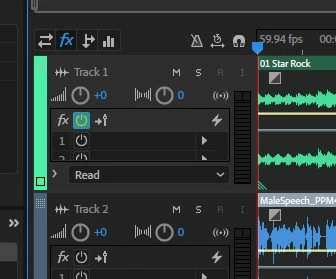

    have you accidentally turned off the Effects rack for the particular track that you are working on? make sure that you are in the FX view of the tracks by selecting the 'fx' icon at the top of the track headers which will change from grey to blue. Then check that the toggle icon for the effects rack is turned on (green) for the particular track. in my image Track 1 FX are on, Track 2 FX are off.
