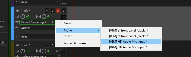

    How are you trying to record in Audition? If you are using Multitrack, you have to assign an input for the track - a lot of people starting out don't realise this!
    But there are also a number of other possibilities. I don't know what you mean about the sample rate - you can only set a single one in the Audition hardware panel. The Zed 14 uses rather a basic USB connection, and it's also only a 16-bit device, but in principle there's no reason why it shouldn't work. I'm assuming that the setting that says 3-USB Audio CODEC is the correct one for the device, but that also looks a bit strange... initially, can you provide a screen-grab of what's on your Hardware settings page in preferences, please?
