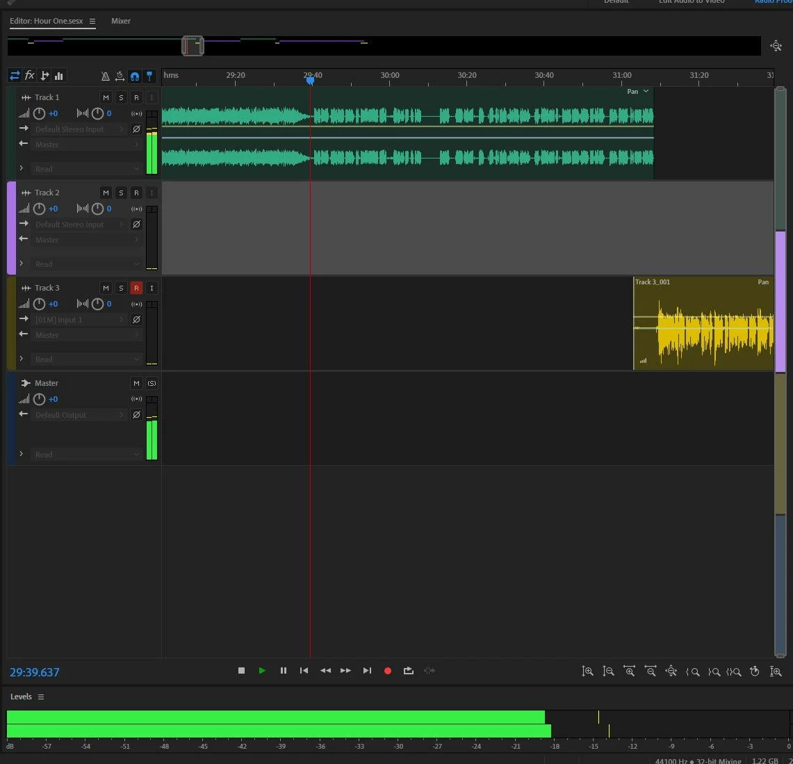

I have finally figured out a way to replicate it. If I open a session and just let it play, the sound will eventually cut out--sometimes after 20 minutes, sometimes a bit longer. Here is a screenshot of what my session looked like when I lost audio just now.

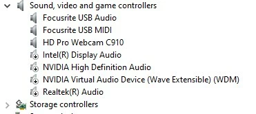

One additional thing I've tried is to disable all the other sound devices in my computer other than the Scarlett. (See second screenshot.)

May 30, 2020 9:01 AM UTC
Looking at your screenshot and specifically the point where the cursor is, the only track in use, Track 1, the waveform representation clearly shows the audio as "fading out".  Is that one of your "silences" (although the meters clearly show audio is being output)?
Further along the same track, again there are "gaps" and some degree of discontinuity in the waveform; are these the "silences"?
