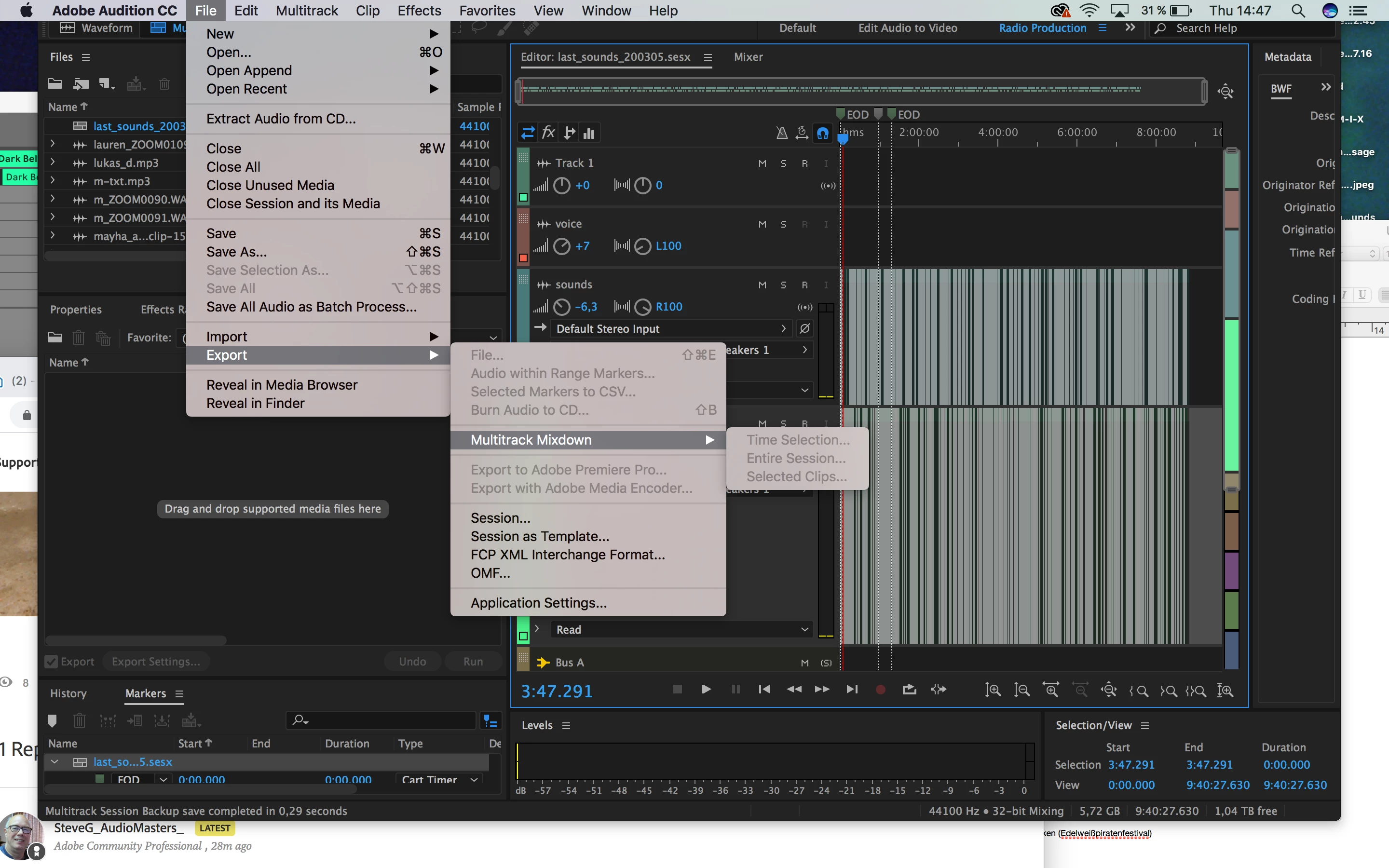

    Hi SteveG! Thank you so much for your reply, it helped me already a lot. I just encountered a strange thing now and don´t know how to deal with it: When I want to do the Mixdown of the file, I cannot save it. Even when I select all the Clips, it doesn´t save anything anywhere. Do you have an idea what the reason for this could be?

    Yeah, I wondered whether I should have made the 'mixdown' bit a bit clearer... I don't think you should be doing it that way.
    Get it all set up in Multitrack view and then go to the Multitrack menu at the top and select 'Mixdown Session To New file>Entire Session' This will create the mixed-down result in stereo, and open it in Waveform view. It is possible to do this in Export, but it's not the easiest way; you have to specify the mixdown options carefully.
    As for what's wrong with your screengrab - the tracks appear to be grey - which implies that they aren't actually 'present' in the mix, and are just appearing as placeholders. If that's the case, then there's nothing to mix down, so no options will show. You need to restore the files to where the placeholders are, by the look of it.
