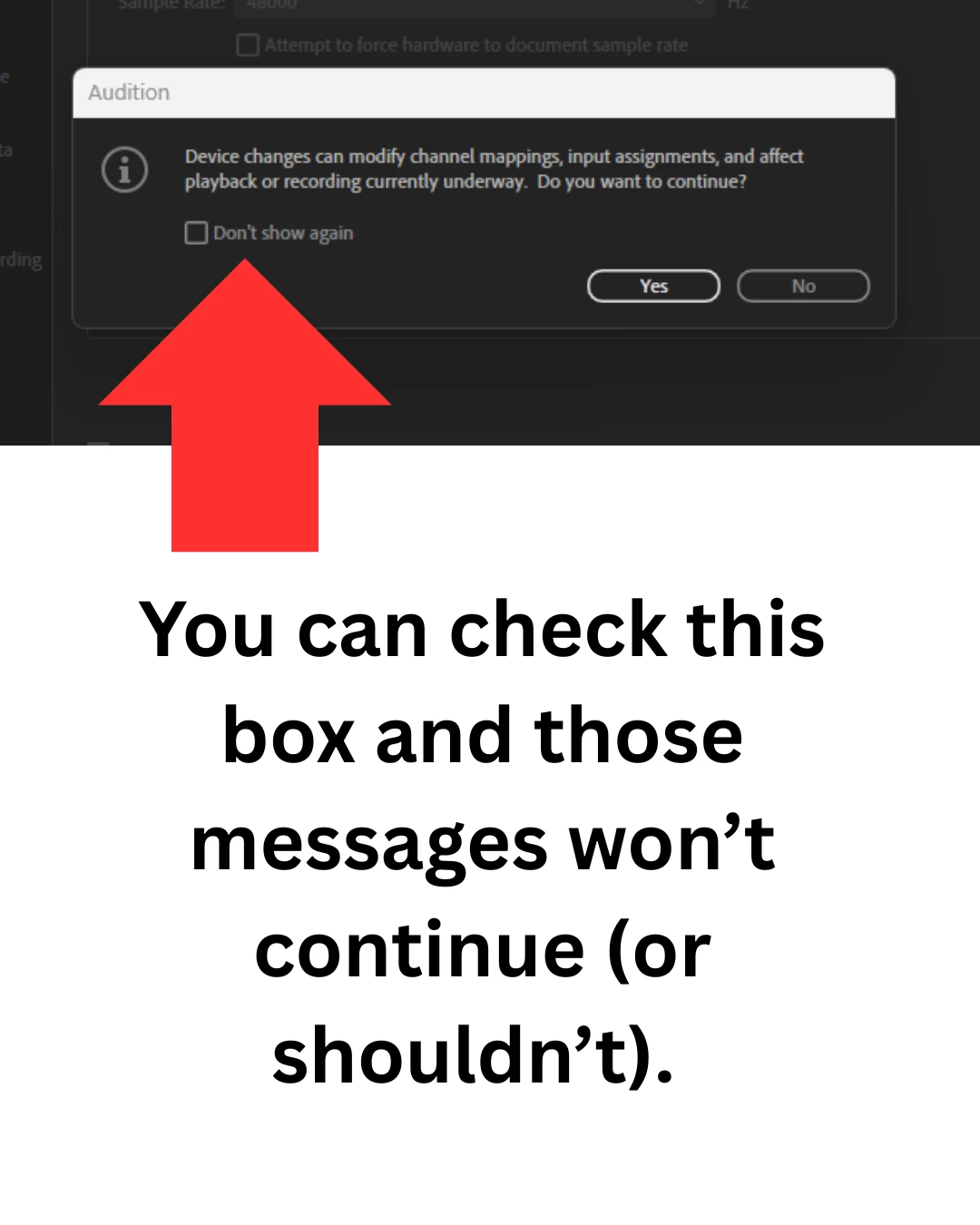

May 27, 2026 12:22 AM UTC
Jay, I’m very sorry to hear of the annoying issue.  I’ve had to deal with it myself as a long time Adobe Audition user.  You can tick off or check the box indicated in the post I attached for your review.  THIS should stop this from reappearing.  Let me know, I’m wishing you good luck, Phil.
