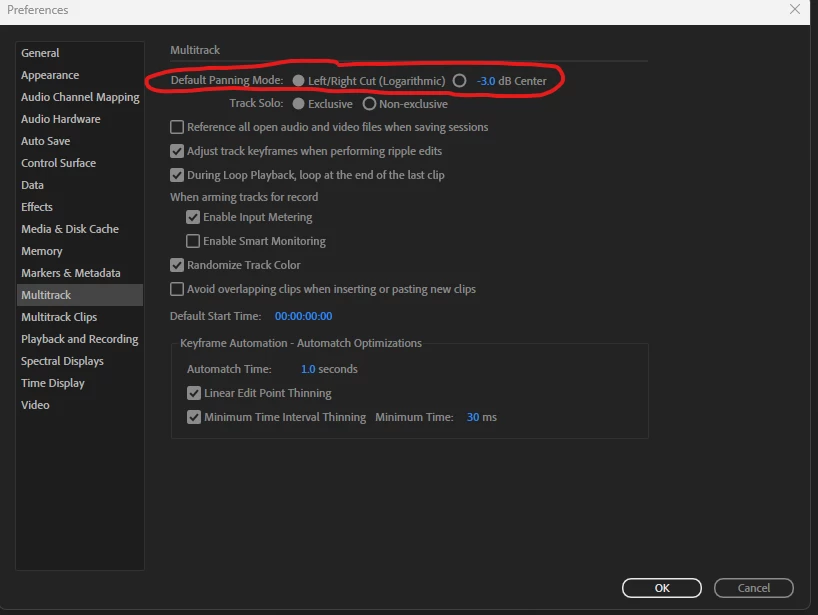

June 9, 2022
You could try changing this setting to -6db Centre.
