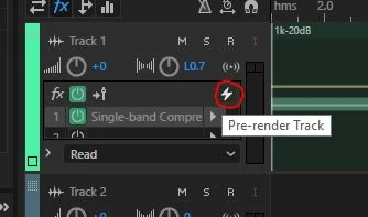

You've either got the latency figure for your sound device set too low, or you have hit the streaming limit for your HD. If you have a lot of tracks, and they have effects all over them, then the thing to do is pre-render them; this means that there will be less of a processing load during the final export. This is quite a common problem. What you are looking for is this:
You can still change your mind if you want to alter anything - this isn't set in stone. Just remove the icon, change whatever you need to and pre-render it again.

I didn't really have a lot of FX on the tracks. On some individual clips I used the essential sounds function on a bunch of the dialogue clips though. I tried the pre-render function but that didn't seem to do it.
