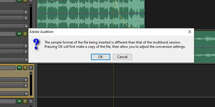

I tried this here just to make sure - if you import two MP3 tracks in Multitrack view and mix them, it works fine - certainly with tracks where the bit rates are the same, anyway. What Audition 3 does in the background is convert these MP3 files back to Wav, as that's what Audition uses internally. On later versions, you get to see the process rather more transparently, as an actual copy is created and put in the file list. This copy is in the format that the session is in. In Audition 3 this only happens if you try to import an MP3 at a different sample rate - you get a message like this:
And subsequently, you get file conversion boxes, but basically you get the MP3 converted to the session sample rate and inserted as a wav file. You can confirm this by looking at the result in Edit view, at the bottom of the screen.
If this isn't what's happening for you, then I think I'd look carefully at whatever the processing options for the second file are when it's inserted, because it sounds as though it's converting the stereo MP3 original into a mono wav file, and inserting that...
