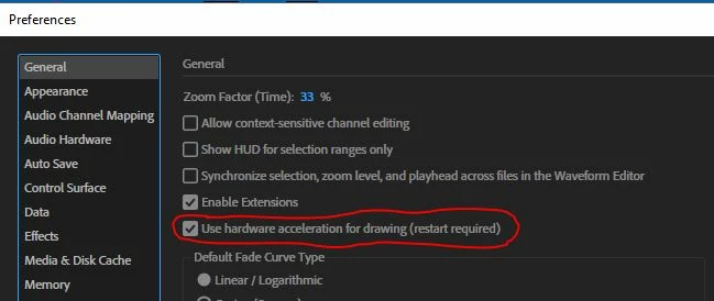

    kaim43548405  wrote
    I am running a dual monitor setup 60Hz/120Hz and have disabled the second one already, but to no avail. I have also checked if Audition can hardware accelerate, but alas I cannot find any option to force it to do that.
    So you didn't find this, then?
    I have no idea as to what's causing this, unless it is indeed a hardware acceleration issue - it sounds like one for the developers.

    kaim43548405
    May 31, 2019 9:36 PM UTC
    Steve, I have no words. First off, I feel honored that you helped me (I came across many of your answers before and you're a legend to me ) - and secondly, for some reason I totally did not see that option there. To my initial dismay, it was activated - and I assumed that deactivating it would make the issue even worse, but alas when doing so (disabling it), it completely fixed all my troubles.
    The question however remains how and why this is happening with enabled hardware acceleration and why videos playing in the background can affect this at all.
    My best guess is that the hardware acceleration and the nVidia drivers are not playing along. If I wanted to let the devs know about this, how can I go about it? I am willing to share any info I can.
