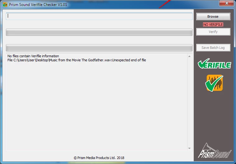

I have recently installed "Prism Verifile Error Checking Software" when I load it into the checker I'm getting
the replay that there's no Verifile data with the File has anyone had the same issue ?

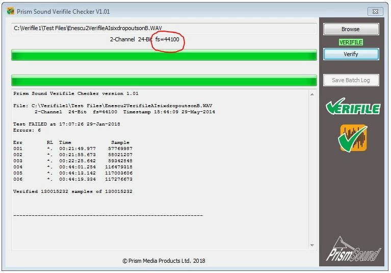

    In Chapter 6.3 of the latest Manual for the Lyra 1 under
    Verifile Checker App there is photo of a 2 channel result
    is that a sample rate of 44100 in the photo ?
    Roger
    Well if it's this one you're referring to:
    Then yes it's 44.1k. But I don't think that the sample rate matters - it's the bit depth and the format of it that counts. Verifile data appears to be encoded into what you might call the 'noise', but as a discrete pattern, and it's this discrete pattern that a 32-bit FP format will lose.

    This is a file that I recorded about 15 Mins ago as you can see there is no Verifile Data
    the recording was made at 44100 24 Bit time 9.12am Thursday the 10th January
