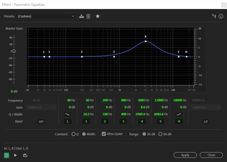

Next use the Parametric EQ. Set it like this:
Finally, normalize the file to -3dB, and then it will sound a lot clearer.
