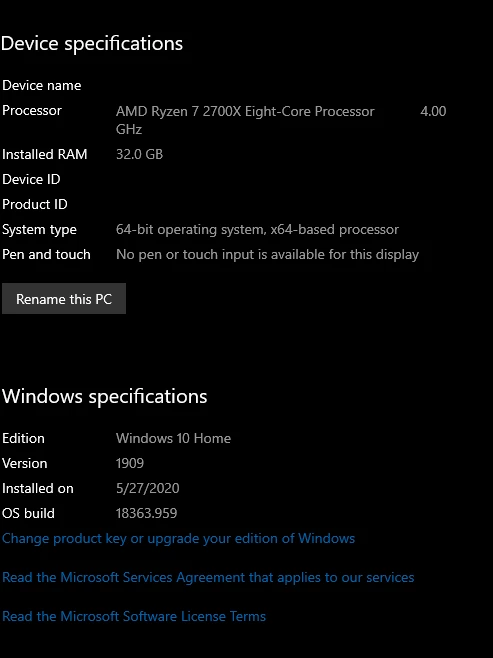

Edit: PC Specs, more than enough to work with Audition.
SuiteSpot
Aug 4, 2020 4:41 PM UTC
I have the same motherboard, cpu and ram - if you want to send me the session and media I'd be happy to do a mixdown and see what happens.

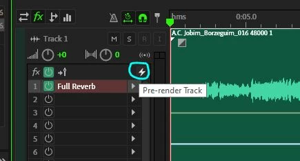

SteveG_AudioMasters_
Aug 4, 2020 4:08 PM UTC
I can't see what that item highlighted in red on your video actually is, but this indicates a device that won't guarantee to play back and work in real time, because it's processor-heavy or has high latency. Unless you've dismissed warnings, one should have appeared when you inserted the effect. The solution though is simple; pre-render that track before mixing it down:
It's the lightning bolt button I circled. If you want to go back and alter something, you can - you just have to go through the pre-rendering process again when you've finished.
