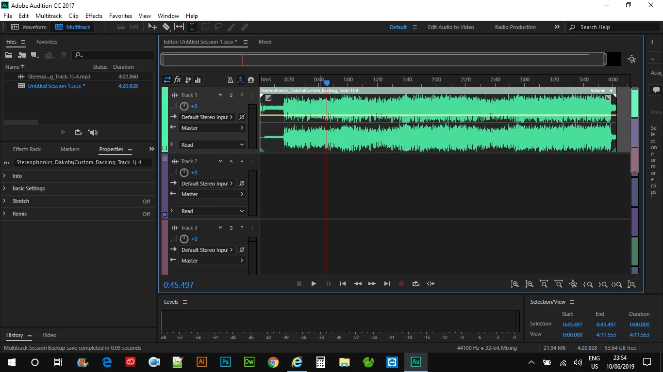

Audition CC 2017 has no pan controls at all.
  • June 10, 2019
  • 856 views
Cannot figure why this is. It is a stereo track but no pan controls anywhere.Any help would be much appreciated thanks. JT.
    Correct answer SteveG_AudioMasters_
    This happens when you put a stereo track into a mono session. Start again with a stereo one, and you'll get balance controls for stereo files (you only get pan controls for mono ones).
    And in case you're wondering, I can tell that it's a mono session simply from looking at the meter bar at the bottom...

    Thank you Steve. You are correct. Was driving me mad! JT.
