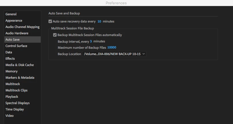

I am editing an audiobook.  I have good 32-bit FP stereo files, on which I just do some basic clean-up, replacing noises with silence, removing mouth clicks, etc.  I have been saving manually every five minutes, and also have preferences set to auto-save every 10 minutes.

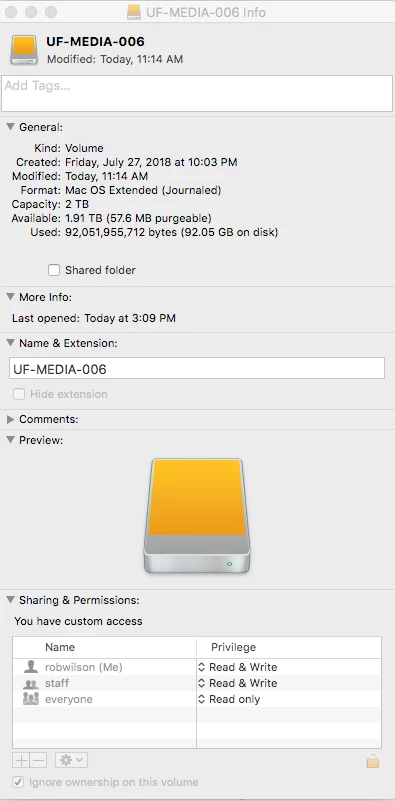

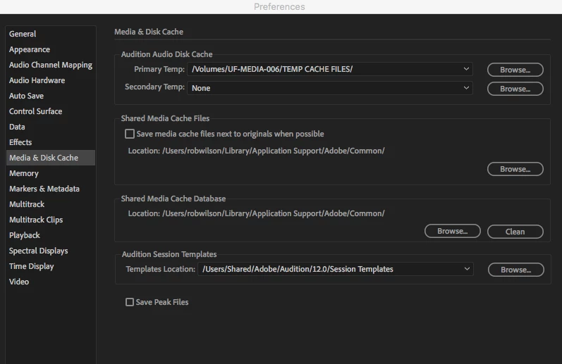

Customer support did some tweaking last night, in the remote share-screen mode, and I see where he re-directed my back-ups.   I'm keeping my files on a removable 2TB drive, and also uploading to Dropbox.
Weary.  Will try customer service again, and any help here, very welcome as always.

    But I'm still not clear - are you editing this bounced-down file (I still don't see why you need that, incidentally) in Waveform or Multitrack? It would be perfectly possible to do most, if not all of that, in multitrack view using the automation system. But what exactly are you doing with the file once you've created it? This file, in it's unedited form, is effectively your new master, and that's the one you should be keeping at least two copies of, and editing only one of them. So initially do a Save, and a Save as, in another location, and don't touch it. If you open up the copy of this file in Waveform view, nothing actually gets altered, whatever you do, until you re-save the file. Until that point, it's stored in a series of temp file locations. Each time you make an edit, it's stored again - the whole thing. If you do a load of edits before saving, then the temp file will become enormous. And, with a big file, it's perfectly possible to run out of temp file space and crash the file... so, if anything at all goes wrong, then yes, I could see the file saving the previous (incorrect) temp location, which would certainly give you a file that's appeared to revert.

    I also have the program set to auto-save every 10 minutes to a separate location.   However.... checking that ... I do not see any back-ups of the WAVE file. And now I see that that function only applies to Multitrack sessions.
