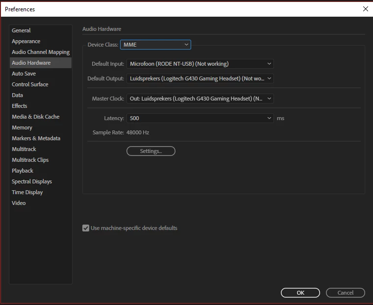

I have installed ASIO4ALL my microphone and headset was idle I set it to active tried again but still not working. Tried MME and WASAPI. Its sad because do have the trial but I cant use it...
I have found the solution !
The problem was that I had turned off microphone use in apps in windows 10.
If you go to settings and turn on microphone use in apps it works.

ryclark
May 27, 2018 11:31 AM UTC
Can you post an image of your Audition Preferences Audio Hardware set up page?
Roy de V
Roy de VAuthor
May 28, 2018 6:42 PM UTC
This is my setup.
SteveG_AudioMasters_
May 28, 2018 9:28 PM UTC
Have a look at the Device Class setting and see if there's an alternative driver shown - like WASAPI - and try that.
