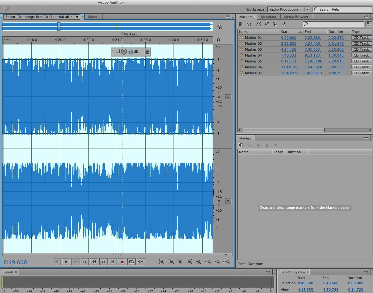

Feb 26, 2013 6:01 AM UTC
Not sure if this is what you are exactly going for considering this is mostly referencing CD's. Assuming that we're cool with not going directly to CD but also digital, here's what I have found to work flawlessly...
I'm a radio personality, DJ, commercial producer and do some VO work as well so I tend to find the most efficient ways to get things done, and done right and CD Layout just doesn't get the job done for me...so here goes (For CS6)
1. Create your markers
2. Change your workspace to Radio
3. Change all markers to "Type" to CD Track on the top right (Note: make the beginning of your first track at 00:00)
4. Select All in the Markers Tab and merge
5. Rename markers as you see fit
6. Edit ID3 as you see fit
7. Select all on the list and click on the small disc icon/Export audio of selected range markers to separate files
8. Save in whatever format you want (I suggest creating a new folder for the project/mix)
aaaaaand voila.

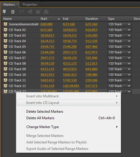

Jan 17, 2013 8:57 AM UTC
In the highlighted answer it says:
Once your tracks have ranges, you can right-click on a track marker in the markers panel and see that it's now possible to add that track to a new or existing CD layout.
I am not seeing that. When I right-click on the CD track marker in the markers panel the "Insert into CD layout" command is greyed out.
Any advice? I just want to burn a CD.

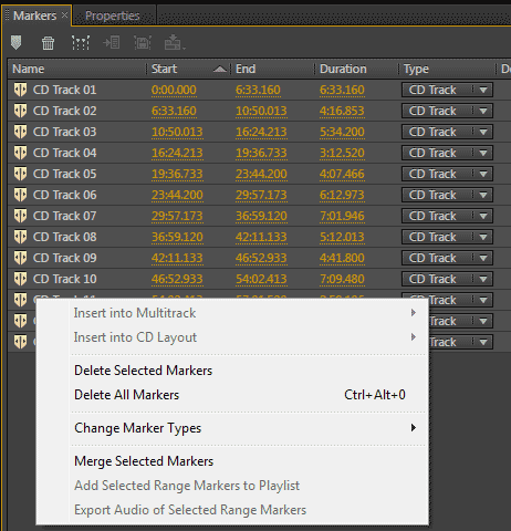

Jan 17, 2013 9:28 AM UTC
Looking at your screen shot, the problem seems to be that you have not highlighted any of the markers.  Once highlighted (and you can highlight all of them) the option to Insert into CD Layout should be available.
Jan 17, 2013 12:47 PM UTC
Thanks for the reply, but it's not that. "Insert into CD Layout" isn't active even when I select one or several tracks. See attached with all tracks selected. (You have to click on the image to see the correct colours. Only then you can see the highlighted tracks.)
