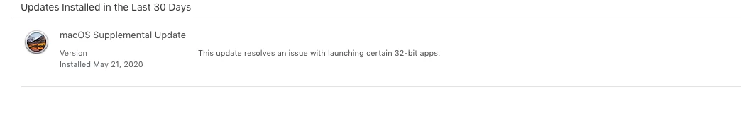

May 21, 2020 8:40 PM UTC
Phil,
First of all thank you for your reply.  I apologize for the response but have been a little sidetracked these past few weeks.  Just as I was getting ready to try this resolution today, an Apple update came out today to resolve this 32 bit problem.  I DID download it and happy to say that I was able to open up CS6 today.  The only quirky thing I notice is when I open up a file, the little file designator to the left is "greyed" out but the file still opens up.  Thanks again for your response and if you have any ideas on the way the files look let me know.  I can "screenshot" it for you....
