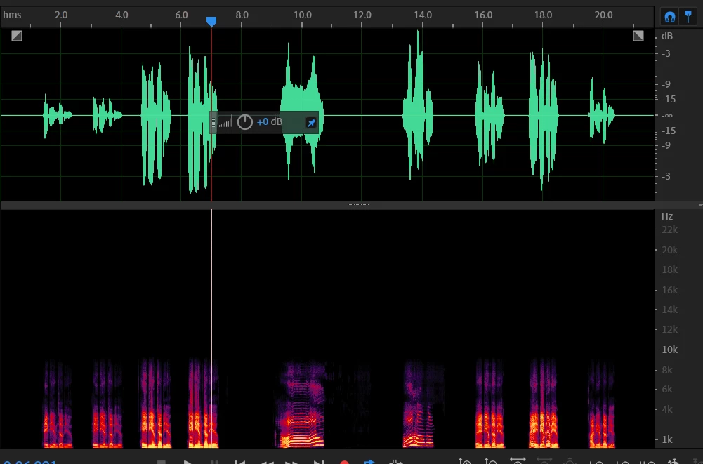

Audition Hz not above 10k?
Hello, I'm pretty new to Audition so hoping this is an easy fix. My spectral frequency peaks are "cut off" at about 10k Hz. How do I adjust my settings so that this doesn't happen? I'm recording in 48000Hz, mono, 16 bit depth, and saving as .wav.

Feb 14, 2023 3:35 PM UTC
Inevitable questions: what are you recording?  Is there actually any frequency above about 10kHz in your source audio?  How are you recording these sounds, mic plugged into your computer, or via an audio interface?  What mic are you using?
Your record settings which you list are fundamentally fine so, since Audition faithfully records exactly what it is given any problem must be occuring in the signal chain before the audio reaches Audition.
Feb 14, 2023 3:42 PM UTC
Thanks for your response. I'm recording vocals via a RODE XLR mic with an Behringer audio interface. I have not tested any microphones, although I am going to try now with my other USB microphone.
Feb 14, 2023 3:47 PM UTC
Hmm. Same result. This is on a USB microphone:
