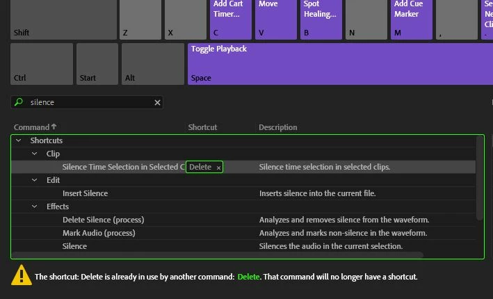

As far as the Delete key goes, the only thing I can think of is this:
I had to create this to achieve what you appear to have as a default. You can check yours by opening the Keyboard Shortcuts (Alt+K) and using the search function, as above. Just as an experiment, I reassigned the Delete key to silence audio rather than delete it, and that's the only way I could achieve this (note the warning at the bottom). If yours doesn't look like this then I suppose that it's possible that something external has re-mapped your keyboard but that seems to be rather unlikely, I think. Anyway, have a look at how it's assigned...
