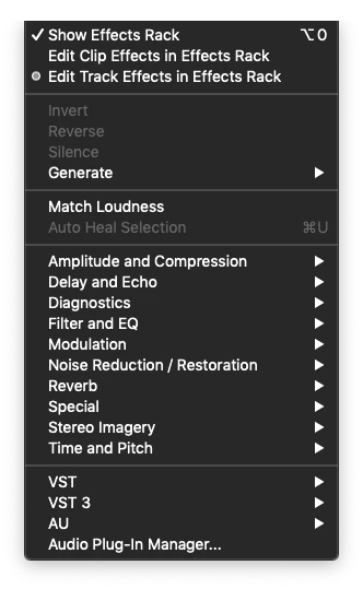

I'm on a Mac ( 2015 PowerBook ) and was having the same problem. I also couldn't find anything helpful online, so even though this thread is a couple years old, here's what I found:
After installing the VSTs (or AU etc) in /Library/Audio/Plug-Ins Audition didn't show any of the installed plug-ins. I tried restarting the software and rebooting my machine to no avail. I tried checking the Auditions "Preferences" to see if I needed to define a VST location. All to no avail.
Then I noticed an item in the "Effects" dropdown that looked promising, so I opened the "Audio Plug-In Manager..."
Clicking that opens a panel that shows your VST locations and your currently installed VSTs:
When I first opened this window it showed the right Plug-In folders in the top section, but the bottom section listing available plug-ins was empty. Clicking the "Scan for Plug-Ins" button did the trick.
