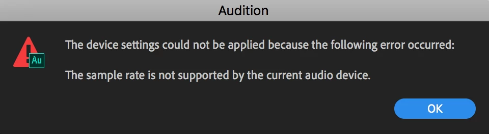

But in Audition Audio Hardware Preferences, the output shows up as Built-In Output (Not Working). Whatever output I try to select (just to see), I get "The device settings could not be applied because the following error occurred: the sample rate is not supported by the current audio device".

    Sorry to hear that you have issues with audio output. As mentioned in the error message, it is certainly a conflict of the audio sample rate set in the app and of the device in the OS. Have you checked the sample rate of the device in the OS?

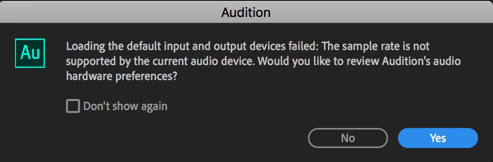

    Here are the messages I get. I would really appreciate if you could elaborate on "conflict of the sample rate set in the app" and of the "device in OS". I do understand that in Audition > Preferences > Audio Hardware there is a sample rate to be set. But what about "device in OS"?
    Now, tweaked something (I think I switched the "default input" to "No Input") and suddenly the headphones work. Still, if you could explain this sample rate situation (or is there a good article somewhere?), that would be great.
