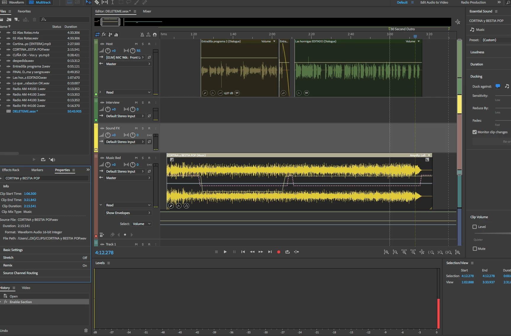

Here is the full screen:
You will see how the autoducking is correctly generating the dotted lines when there is an overlap with the dialogue track.

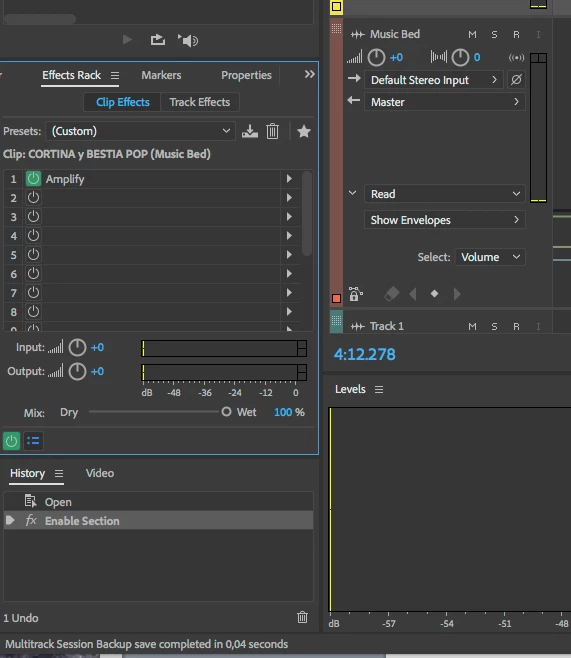

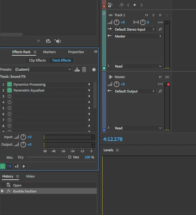

I don't know what you want to see at the left side. In the image above you can see track properties, but I also captured these:
Above you can see the Effects Rack with Clip Effects and Track Effects open.
If you need anything else just let me know.
