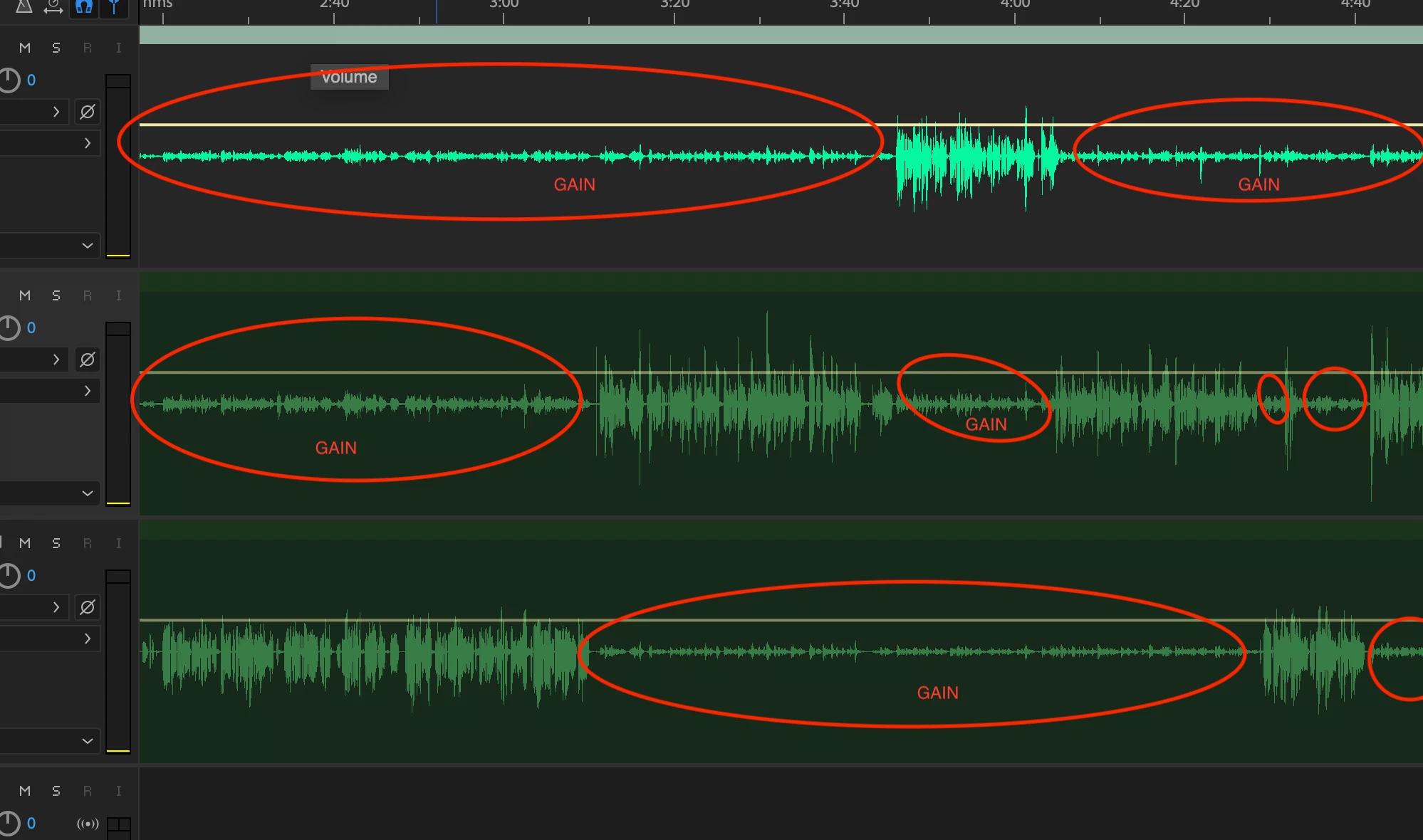

Thanks for your thoughts. I did try it but the dynamics processor also seems to affect the parts i need vocal to be untouched.
any idea where to look at for specific settings?
i'm attaching the multitrack screenshot (gain circle means gain out)
thanks!
