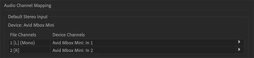

Feb 12, 2020 12:30 AM UTC
Yep, glad to contribute, settings for the Mbox in the MIDI and Audio configuration were incorrect, input at one rate and output at another rate even with Audition set to use a different output, meaning, input from Mbox and output from integrated headphone jack. As simple as that. The little piece between the chair and the screen (me in this case) never thought about it and kept configuring input only.

Feb 9, 2020 7:50 PM UTC
Are you saying that Audition is not receiving signal - or Audition is not recognizing the device? It works here on Mac with no issues.
-paul.
Feb 10, 2020 9:07 AM UTC
Not receiving signal, it is configured exactly as the screenshot you posted. My iMac is running High Sierra 10.13.6 and the Macbook running Catalina latest version, neither one works. As I posted, the Mbox setup as an audio device in OS is fine because Garageband recognizes it.
