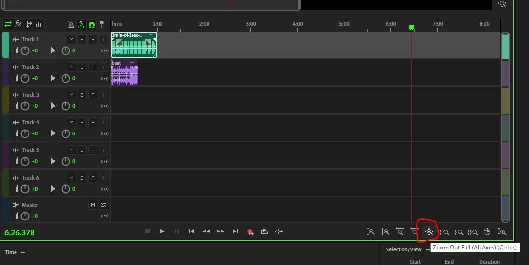

Make sure that the zoom bar is in a little bit from the end so that the Zoom Out Full (all axes) control is illuminated:

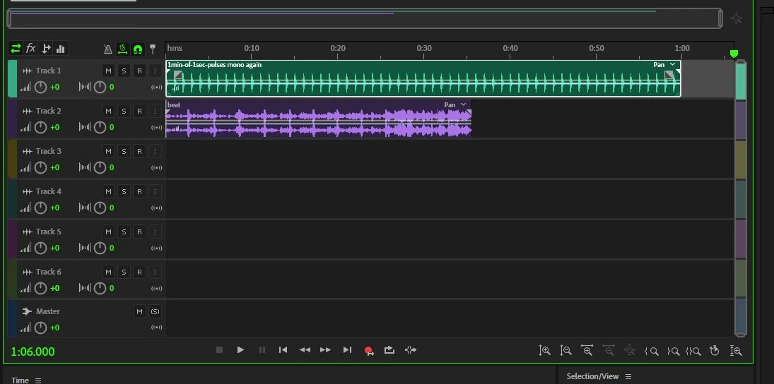

Click on it, and this will happen:
Ctrl+\ should work as well, but you do need to be zoomed in a little bit to get the tool to illuminate. Obviously it doesn't work if you've already zoomed right out! But yes, this resets the workspace.

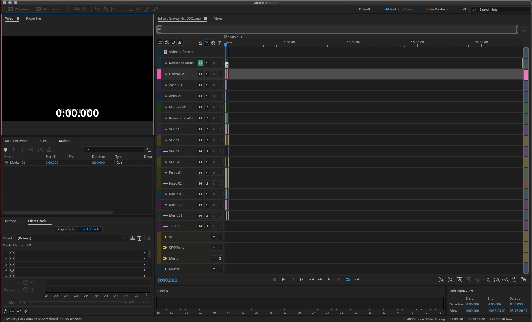

GMartin58
GMartin58Author
May 4, 2020 5:31 PM UTC
Steve...that's not doing it for me. I zoom in a bit and click the Zoom Out Full button...and it zooms out full so I have this huge blank space. Nothing is reset.
