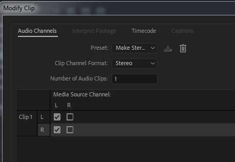

Oct 8, 2021 12:42 PM UTC
SteveG,
Thank you very much for your quick answer. I was afraid of that, but I was hoping I was missing something.
Regarding Premiere: I had previously thought I couldn't double a mono track into stereo within Premiere, but you made me look into it again and, turns out I can! It's actually quite simple and I can use my original (mixed stereo) file, side stepping Audition altogether.
a. Import "mixed" stereo file into Premiere (say Audio1 as before)
b. Right-click on "mixed" stereo file.
    - Modify / Audio Channels
    - Clip channel format: Stereo
    - Number of audio clips: 1
    - Select Left Channel "L" for both "L" and "R" in Clip1 (in my case)
    - Ok
This works for all subsequent uses of the clip, NOT on clips already in the timeline.
So, thanks again for your answer and for making look into the problem from another angle.
