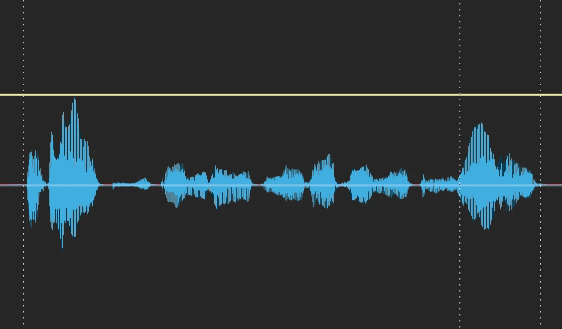

I have a recording of a voice performer who lowered his voice a little at the end of a sentence. You can make out the words he is saying at the end, but they need a little boost. Is there an easy way for an idiot like me to give those last few words a boost without sounding too unnatural? All I would think I could do in that situation is gradually raise the levels at the end, but that sounds artificial.
In case it matters, this is what the meter looks like.
And this is what it sounds like.

    Is the image that you are showing from the Multitrack view? If it is then you have the necessary tool waiting there in front of you. The yellow line is the Volume Envelope line. All you have to do is click on it above where you want to increase the level and a keyframe 'diamond' icon will appear on the line. This you can then drag up/down and left/right to alter the volume of the audio and exactly where you want it altered. In order to just do it for a few words you will actually have to create four keyframes, a pair at the start and a pair at the end of where you want the volume changed. If they don't work as intended you can right click on them and use delete from the drop down menu.

    Thank you for your reply. I have already tried that, and it sound right, because the rest of the room noise is being boosted along with the words. When I listen to it, it sounds like someone is cranking the volume up and down for a moment.
