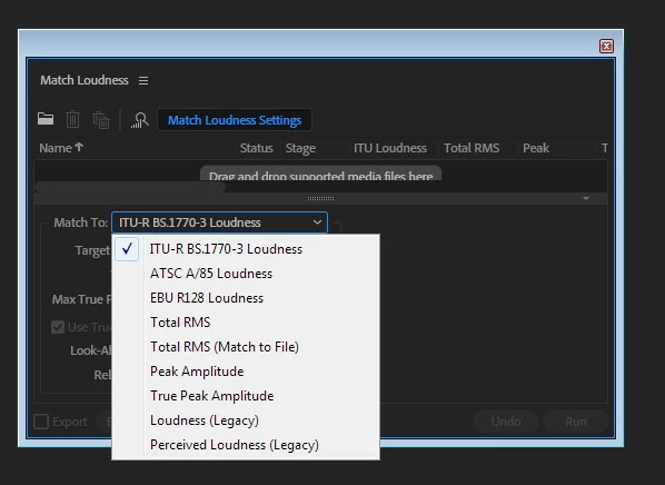

    Apr 12, 2018 11:50 AM UTC
    Yes recent versions of Audition have Match Loudness under the Effects menu. There are several profiles including the latest International ones and some of the older Audition ones. The Match Loudness feature is a batch type feature which opens it's own page where you can drop all files to be matched, set up the parameters and export settings.
    Apr 12, 2018 2:47 PM UTC
    That cool - and I can definitely see how it will be useful for mastering an album. But what about a single file - not looking to "match" loudness to another file, but to have one file edited to hit a target average loudness. Will I be able to do that?
    Thanks!
    ryclark
    ryclarkCorrect answer
    Apr 12, 2018 4:30 PM UTC
    Yes, just drop the single file into the Match Loudness space. Unlike Match Clip Loudness, which compares the different clips and tries to make them match each other, Match Loudness batch process conforms just the added files to the required profile.
