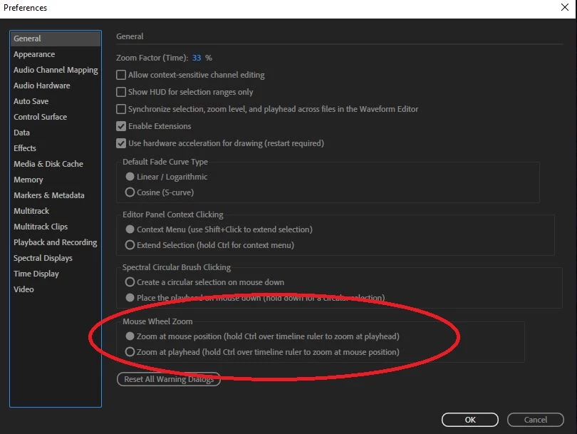

Likewise, the only functionality I could find in Audition related to the scroll wheel is tied exclusively to the Control key in the General Preferences).

As far as I'm aware, there is no mechanism for controlling scroll wheel behaviour at all in Audition other than the ones you've already found; this has been a bone of contention for years, and Adobe have steadfastly refused to do anything about it - I think because they believe that this is a Windows issue, not an Audition one. There are plenty of people who wouldn't agree with that, but there's nothing we can do about it; we appear to be completely without influence in that area!
