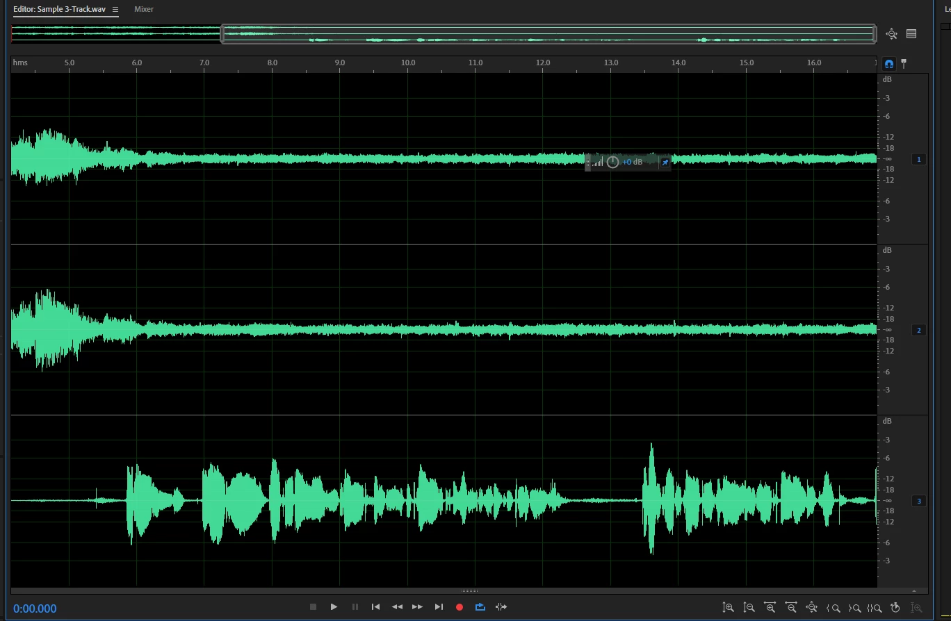

Can I listen to a 3-track recording in Waveform mode?
I have some 3-track recordings from a Tascam 144 cassette, recordings made in the 1980s (stereo soundtrack on Tr1-2, commentary on Tr3). They are Wave files. When I open the recording, all three tracks appear, but only the top two are audible.
What I've had to do is extract the tracks to mono files, open in Multitrack, pan and so on. But is there an easier way in Waveform mode just to hear the tracks as they were originally: Tr1 and Tr2 in stereo, Tr3 in the centre?
Attached is an extract.

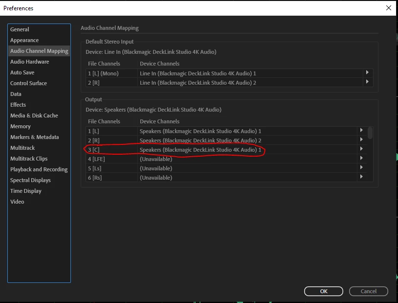

Right clicking on my 'numbers' only seem to let me rename the box, it doesn't alter what I can hear. Selecting my number 1 the box to read 'right' still comes out of the number 1 channel.
SteveG_AudioMasters_
Apr 19, 2021 10:06 AM UTC
That's because you have a stereo interface, and the third channel you've allocated says 1...

I knew there would be a better way but where do you find the boxes that say left and right. It might be because I have a multi channel interface but this is what I have.
Apr 14, 2021 3:21 PM UTC
On yours they say 1,2 &3. By default with a stereo interface they say L and R. If you right-click on the numbers, you'll see what I mean!
Apr 14, 2021 10:20 AM UTC
There's a way to hear all three, but the third one has to be in either the left or right channel - you can't pan it to the centre. At the RH end of the waveform display there are boxes that say L and R. If you right-click on the one you can't hear, then you can select either R or L. I haven't tried what Richard is suggesting; that may improve things, but I suspect it won't, because there's still no panning option available for the track. In a multi-channel interface it would work, but not in a stereo one.
Apr 14, 2021 10:18 AM UTC
This is not the most elegant solution but I can hear the three tracks played through a 2 channel audio device using the following setup:
