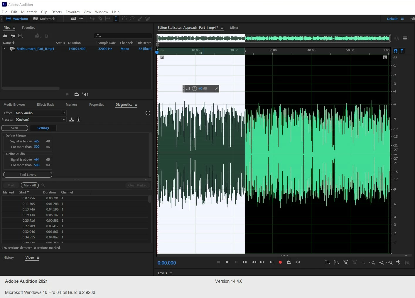

Aus5F9DAuthor
Aug 11, 2021 10:29 AM UTC
I tried many different settings for noise levels. Here markers are correct for a 20 mins segment
And here is what I get for the whole video. I selected it but the same happens without selection
First segment changes from 0.8sec (word "Hello") to 1min 32 sec.
SteveG_AudioMasters_
Aug 11, 2021 4:45 PM UTC
I realise what you're saying - but I still think you should experiment more with the 'for more than' setting. 300ms is more like a typical figure for this.
