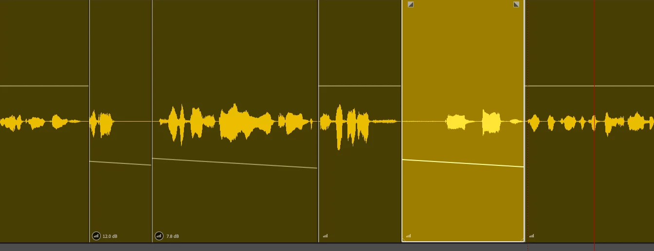

I rearragned a few spliced clips in one track, and now those clips have a lower volume that cannot be changed. The volume envelope line is completely stuck; I can neither move it nor add control points to it on the rearranged clips. Is there any way to regain control of the volume on those clips?

In the Multitrack menu, do you have Enable Clip Keyframe Editing enabled? That's exactly what will happen if you don't...

Thanks for the reply. Yes, I do have keyframe editing enabled, and it works only on the clips of the track that weren't rearranged.

If you select one of the clips you can't do anything with and go to Clip>Clip Gain, can you adjust it at all this way? So far, I've failed to reproduce this issue at all...
